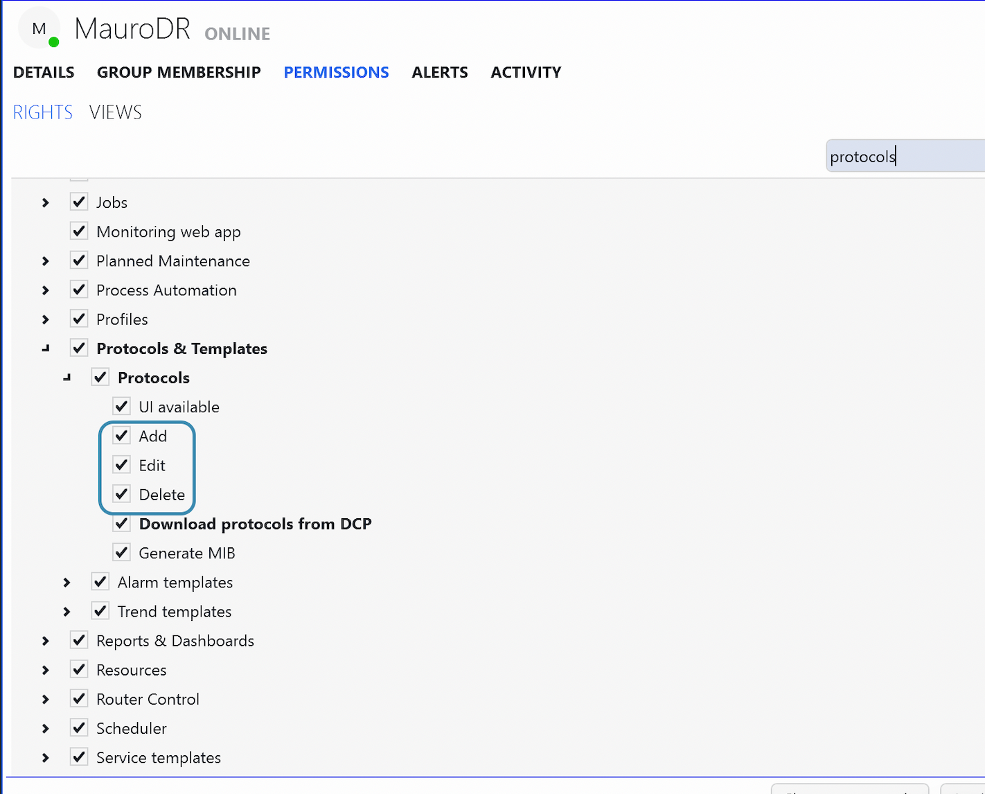

Mauro Druwel [SLC] [DevOps Advocate]704 Posted 28th July 2026 1 Comment
Hi Paul,
Since it publishes fine on one system, this is almost certainly a permissions difference between the two systems!
In DataMiner Cube on the failing system, go to System Center > Users/Groups and check the user group assigned to your account. Make sure you have the following rights granted:
  • Modules > Protocols & Templates > Protocols > Add (if uploading a new protocol)
  • Modules > Protocols & Templates > Protocols > Edit (if updating/adding a new version)
If your account lacks these on that specific DMA, SLNet will reject the publish attempt.
Hope this helps!

Thanks for your reply. I'm afraid I already have those rights and it still can't let me publish the new version.
I've found that there is only one DMS that I can publish the protocol to. I have tried 5 DataMiner Systems in total but only one of them worked. I have all the rights across all systems.
