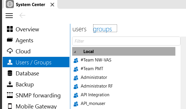

Hi Dojo!
I wanted to ask if it's possible in Visio to display different pages based on the user group a user belongs to.
I’m aware that we can control visibility using security levels or depending on whether the user is accessing via DataMiner Cube or the web interface, but I was wondering if there is a specific parameter or method to directly use user group membership for this purpose?
Thanks in advance!
Yahya

Thank you, Toon, for your response.
To further explain my use case:
We have users from two different groups, both with access to the same view.
Users from Group 1 would like to see a specific Visio page on that view, while users from Group 2 prefer a different Visio page, also within the same view.
Is it possible to show a dedicated visio page for a certain group?
