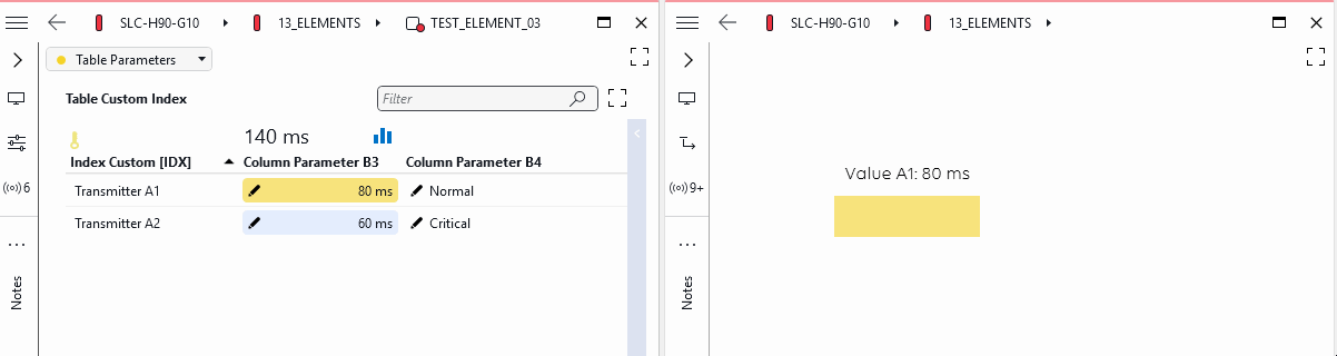

Hi Jain,
Can you upload again your screenshots?
I created a small mockup to simulate your use case, and I am able to visualize the alarm from the parameter:
Block A1:
Parameter: 2003:Transmitter A1|ALARM
Show: <A>-A|TEST_ELEMENT_03|2004:Transmitter A1|=Normal
Text for block A1:
Paramater: 2003:Transmitter A1
Block A2:
Parameter: 2003:Transmitter A2|ALARM
Show: <A>-A|TEST_ELEMENT_03|2004:Transmitter A2|=Normal
Text for block A2:
Paramater: 2003:Transmitter A2
Group shape:
Element: TEST_ELEMENT_03
Below a small animation that shows how the shapes are shown/hidden based on the values of another column parameter:
Hope it helps.
