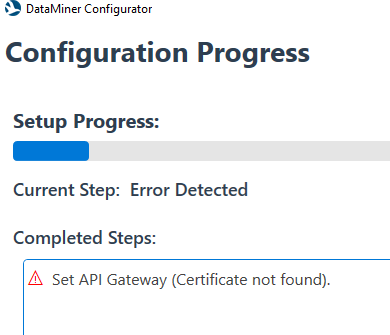

After installing DataMiner in a new Windows server 2019 VM, I tried to execute the Configurator Tool to register the DMA in dataminer.services. However, after several retries, I always get the below error:
Set API Gateway (Certificate not found)
The log files indicates that the the tool was unable to find an auto-created certificate:
[2026-07-20 00:44:23.831] [INF] Certificate 'Auto-Created Certificate by DataMiner APIGateway' not found (attempt 1/10). Retrying in 2000 ms...
[2026-07-20 00:44:25.833] [INF] Certificate 'Auto-Created Certificate by DataMiner APIGateway' not found (attempt 2/10). Retrying in 2000 ms...
[2026-07-20 00:44:27.841] [INF] Certificate 'Auto-Created Certificate by DataMiner APIGateway' not found (attempt 3/10). Retrying in 2000 ms...
[2026-07-20 00:44:29.842] [INF] Certificate 'Auto-Created Certificate by DataMiner APIGateway' not found (attempt 4/10). Retrying in 2000 ms...
[2026-07-20 00:44:31.844] [INF] Certificate 'Auto-Created Certificate by DataMiner APIGateway' not found (attempt 5/10). Retrying in 2000 ms...
[2026-07-20 00:44:33.845] [INF] Certificate 'Auto-Created Certificate by DataMiner APIGateway' not found (attempt 6/10). Retrying in 2000 ms...
[2026-07-20 00:44:35.847] [INF] Certificate 'Auto-Created Certificate by DataMiner APIGateway' not found (attempt 7/10). Retrying in 2000 ms...
[2026-07-20 00:44:37.848] [INF] Certificate 'Auto-Created Certificate by DataMiner APIGateway' not found (attempt 8/10). Retrying in 2000 ms...
[2026-07-20 00:44:39.850] [INF] Certificate 'Auto-Created Certificate by DataMiner APIGateway' not found (attempt 9/10). Retrying in 2000 ms...
[2026-07-20 00:44:41.851] [ERR] Certificate 'Auto-Created Certificate by DataMiner APIGateway' not found after 10 attempts.
[2026-07-20 00:44:41.854] [INF] WizardViewModel. ConfigurationProgressChanged: 10
[2026-07-20 00:44:41.855] [INF] ConfigurationProgressViewModel. ConfigurationProgressChanged: 10
I had a look a the DataMiner Docs and I could not find a way to troubleshoot this issue. Please could you let me know what could be wrong?
Thanks.

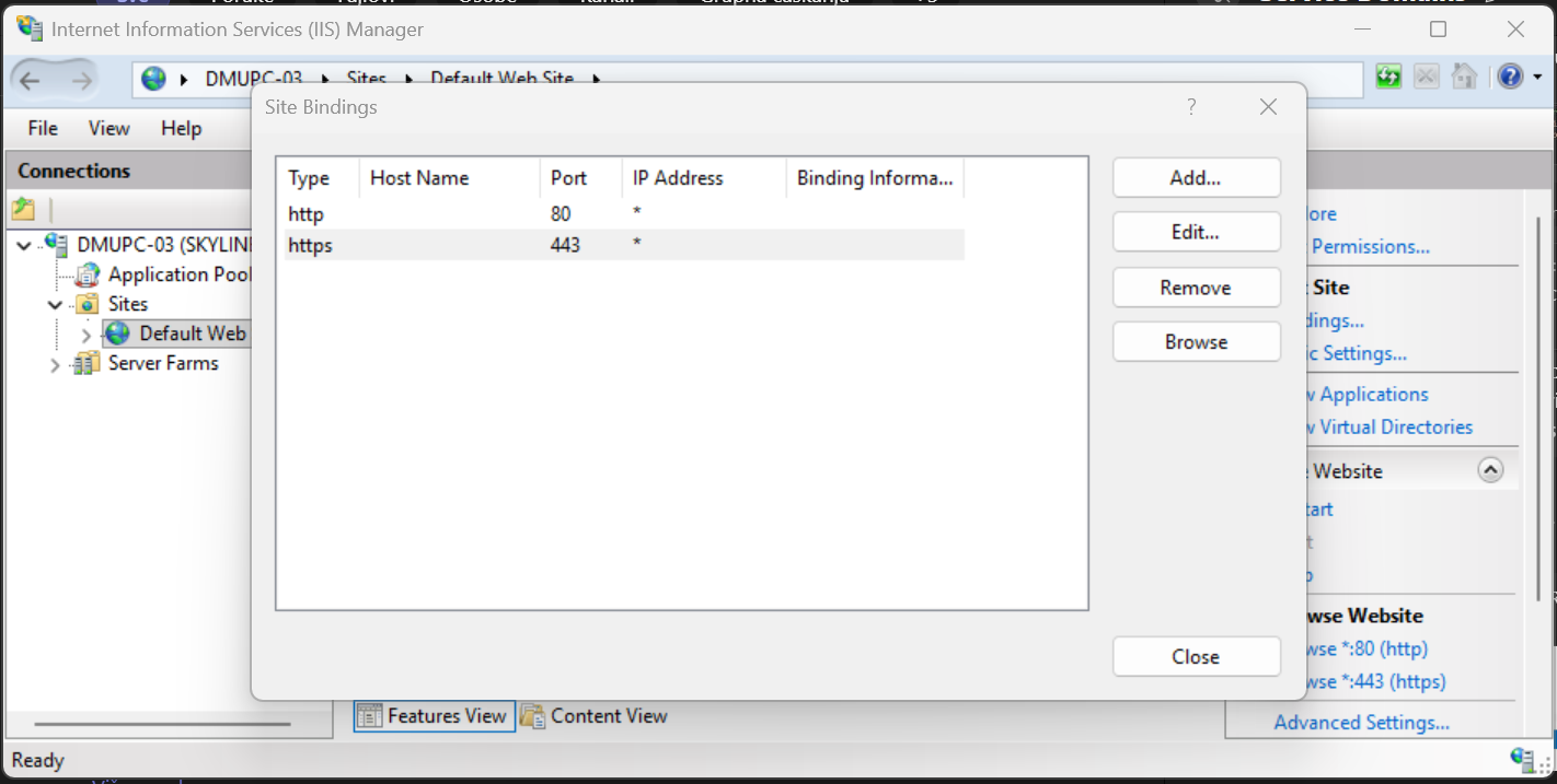

Miguel Obregon [SLC] [DevOps Catalyst] Selected answer as best 20th July 2026
Miguel Obregon [SLC] [DevOps Catalyst] commented 20th July 2026
Hi Tarkik,
Thanks for your answer. According to the installer UI, we are running version 1.0.0.0. We downloaded the installer from Dojo last week.
Indeed, removing the binding to 443 solved the issue. However, in our case, there was only a single binding to 443. To remove this binding, we have to create first a binding to HTTP (port 80).
