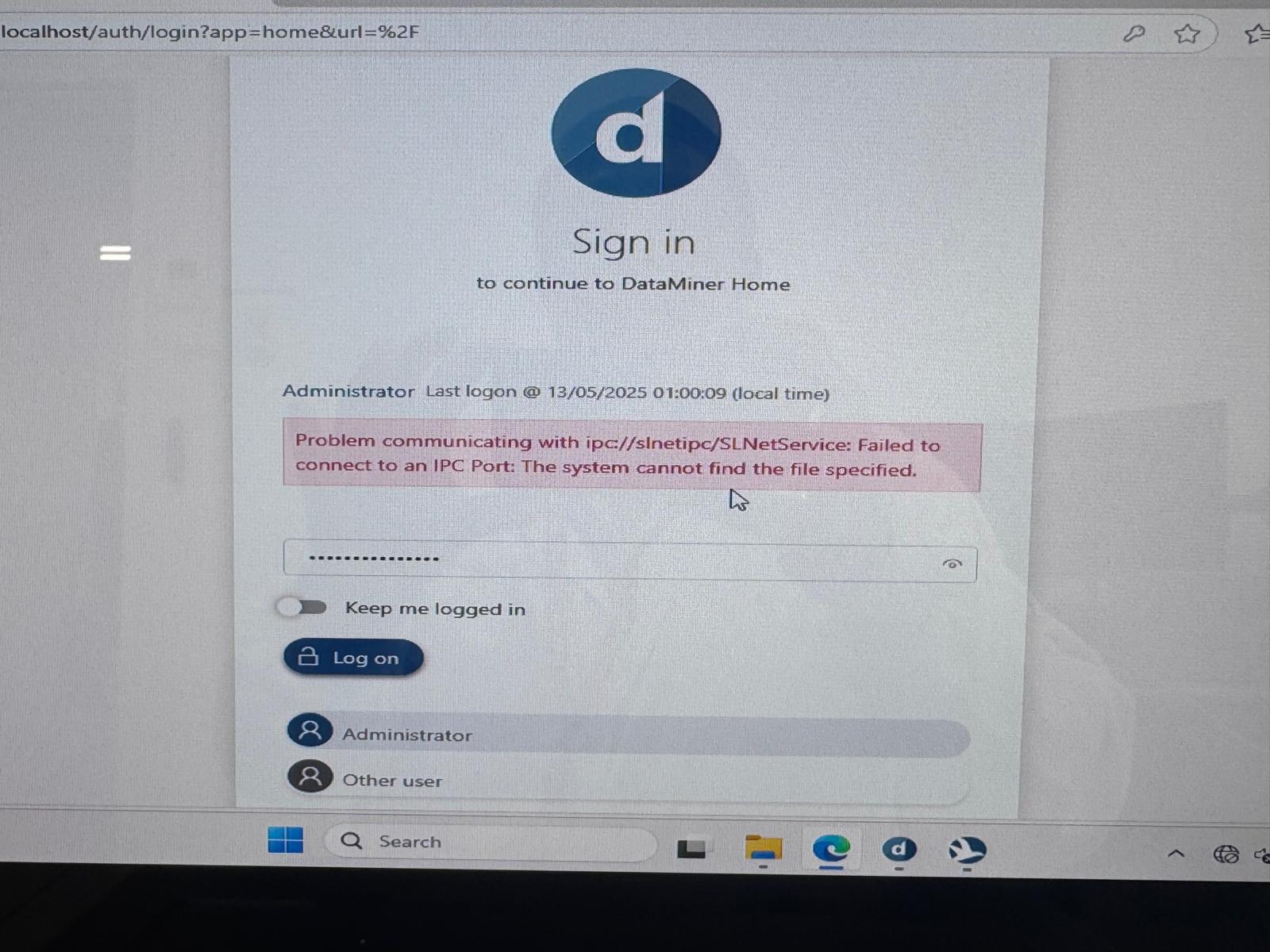

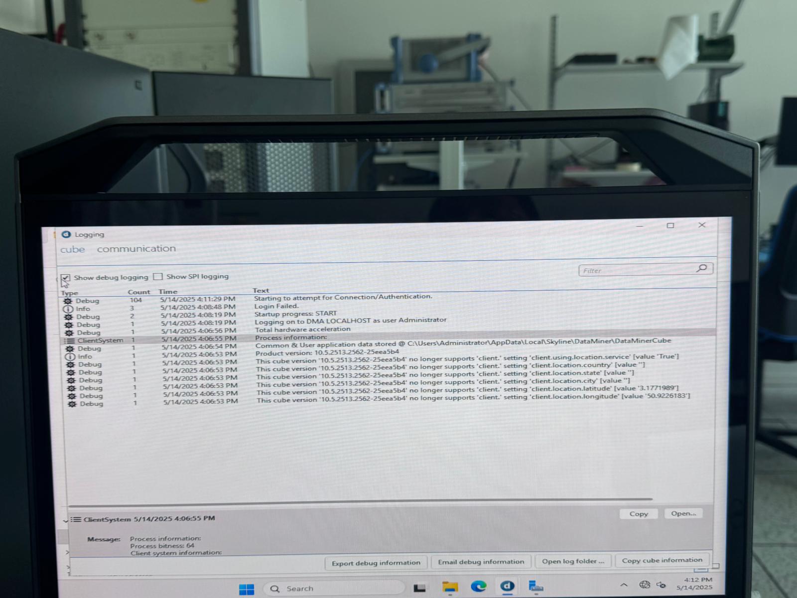

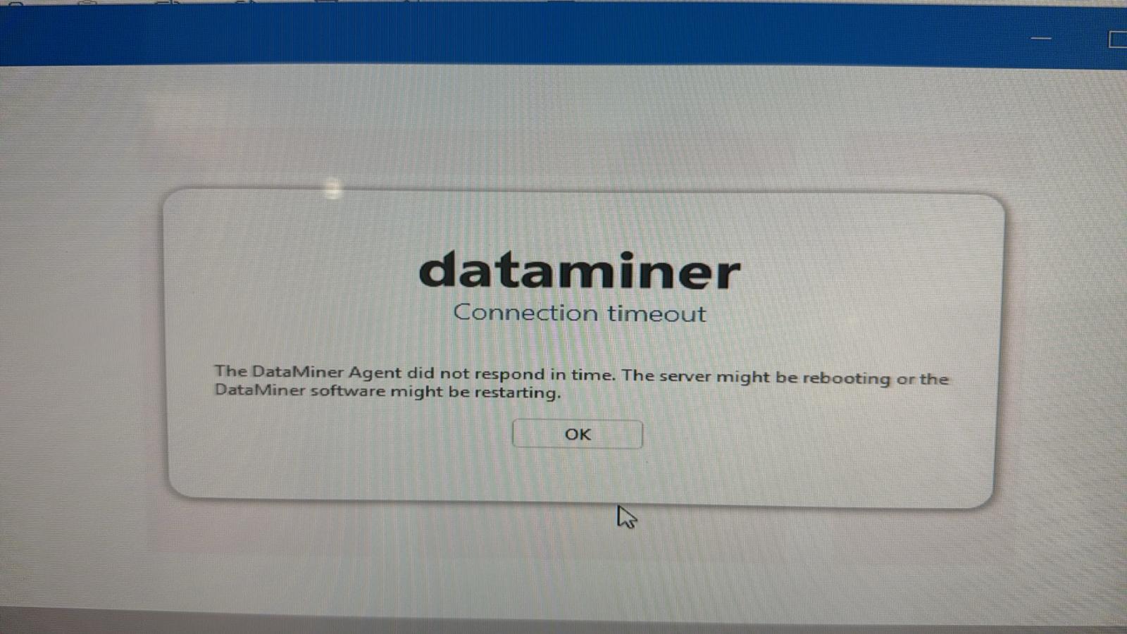

I am unable to connect the dataminer agent.

Update: Tech Support was able to resolve this issue for Manas.
The root cause was that DataMiner had been assigned an incorrect IP address
as the change was not properly done manually. This was purely a configuration issue.

Hi Manas,
It looks like your DataMiner system is probably not correctly started up as it should... It's difficult to troubleshoot this via a Q&A. Therefore, it might be best to contact techsupport@skyline.be or you could also try to start a troubleshooting session yourself with this guidance: Troubleshooting: Where to start? | DataMiner Docs
