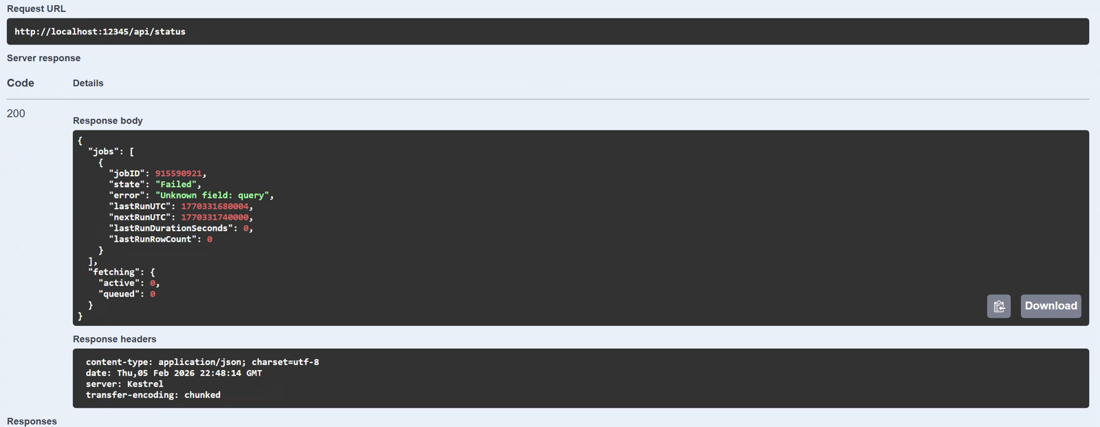

I can confirm the same error on the Swagger page when checking the job status:

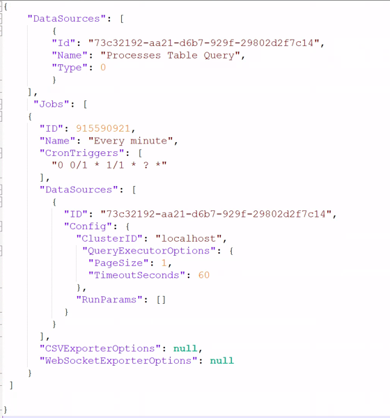

I configured my GQI query using the export method, following the documentation. The query utilizes a "Get Parameter Table by Id" data source and includes a Select statement to extract only specific columns. Here’s how I set up my Helper.json:

The problem was caused by a mismatch between the default configuration of the Data Aggregator module and the GQI module.
From DataMiner version 10.6 onwards, GQI DxM is used by default, but the Data Aggregator still uses CoreGateway and SLHelper to execute the configured queries. To solve the mismatch, it would be advisable to configure the Data Aggregator to also use GQI DxM by setting the following:
  • In the appsettings.custom.json, enable the query execution via GQI DxM by adding the following section:
"QueryExecutorOptions": {
"UseGQIDxM": true
  • Configure the Data Sources in the Helper.json to use contract 1:
"DataSources": [
"Id": "608e37cf-398c-d2e5-4a38-0d4c7bc91fd0",
"Name": "Processes Table Query",
"Type": 0,
"Contract": 1
The above settings are explained in the configuration section of our documentation.
