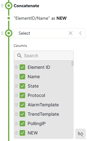

Would it be possible to reorder the columns created by column manipulation in Queries? I'm looking to achieve the reordering that can be done with the columns selected from the dataset.

The new columns that are generated after the column manipulation node are included in all nodes that come after it. Adding a select node after the manipulation should allow you to re-order the column.

Thank you for guidance. I managed to reorder the columns.
