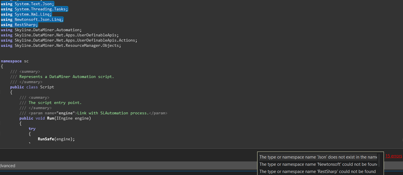

Right now I’m writing an automation script for controlling API calls.
I watched a video, installed all the packages shown in it, and made some modifications.
Kata #2: User-Defined APIs
I also added custom libraries via NuGet Package Manager:
main important libraries :
using Newtonsoft.Json.Linq;
using RestSharp;
etc.
However, after publishing and validating in the DataMiner Cube, I get 15 errors saying it can’t resolve the libraries.
How can I fix this? Or are there alternative libraries or functions I can use?
Thanks in advance!

How did you write and publish the script? If it was through DIS it should create an install package and deploy that through DIS.
Ömer Eryaman [DevOps Member] Posted new comment 27th August 2025
Ömer Eryaman [DevOps Member] commented 27th August 2025
Like in the video, I opened a Visual Studio project for automation and installed the packages using the NuGet manager. How do I get the Skyline Dev package, like in the video?
I will try creating a new project—maybe I skipped a step.
Thanks
