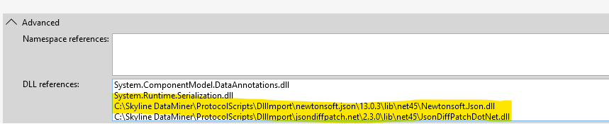

Right now I’m writing an automation script for controlling API calls.
I watched a video, installed all the packages shown in it, and made some modifications.
Kata #2: User-Defined APIs
I also added custom libraries via NuGet Package Manager:
main important libraries :
using Newtonsoft.Json.Linq;
using RestSharp;
etc.
However, after publishing and validating in the DataMiner Cube, I get 15 errors saying it can’t resolve the libraries.
How can I fix this? Or are there alternative libraries or functions I can use?
Thanks in advance!

Kévin Dugué [DevOps Enabler]863 Posted 28th August 2025 1 Comment
If you did not publish from DIS. You should add the dll reference in "Advanced" settings.
Example here with Newtonsoft.Json.dll

David Merrifield [DevOps Member] commented 29th August 2025
Had the same problem. Adding the DLL references here in the advance settings fixed it for me. Not sure why DIS doesn't do it for me.
