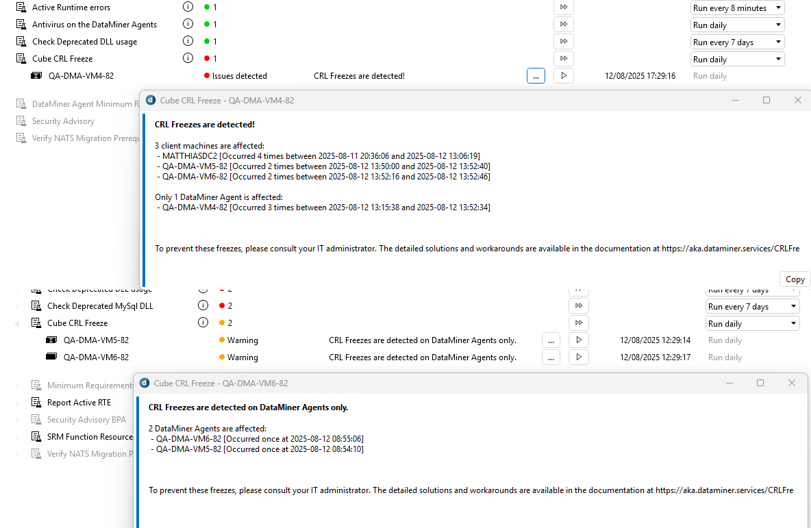

Is there a way to reset the cube crl freeze BPA to check if there are no new occurences?

The Cube CRL Freeze BPA checks the number of occurrences based on the SLClient log files on each DataMiner Agent.
If you want to start from a clean slate, there are two options:
  • Restart the DataMiner Agent, which clears the log files on startup
  • Or let new log entries overwrite the old ones over time, which will also remove the previous occurrences from the logs
For the second part (checking for new occurrences):
The BPA details include the timestamp of the most recent occurrence. That makes it easy to see if anything new has happened after the restart.
I’ve added a screenshot from development below. It’s not exactly the same as what you’ll see, but it shows where that timestamp is displayed.
Hope that helps!

Indeed, it cleared after an failover/restart 🙂
