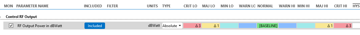

I'm trying to ceate a Dynamic Threshold Alarm for RF Output Power.
I have Baseline selected under the Normal column, with Absolute set as the Type.
I'm not sure if my understanding of the values is correct however!
I have set, what I think is the MAJ alarms as +/- 1dB and the CRIT alarms as +/- 3dB.
Can anyone confirm this or point me in the right direction?

How do you plan to manage your baselines (Automatic or Manual Configuration)? Can you share an image how [BASELINE] is defined currently? Just need to click on that cell/text under normal and see a new pop up.
Kris Pill commented 19th January 2026
The Baseline value has been added manually.
Just watched one of the e-learning videos again, to refresh my memory and it confirms that my thought process was indeed correct. Thank you for reaching out though!
