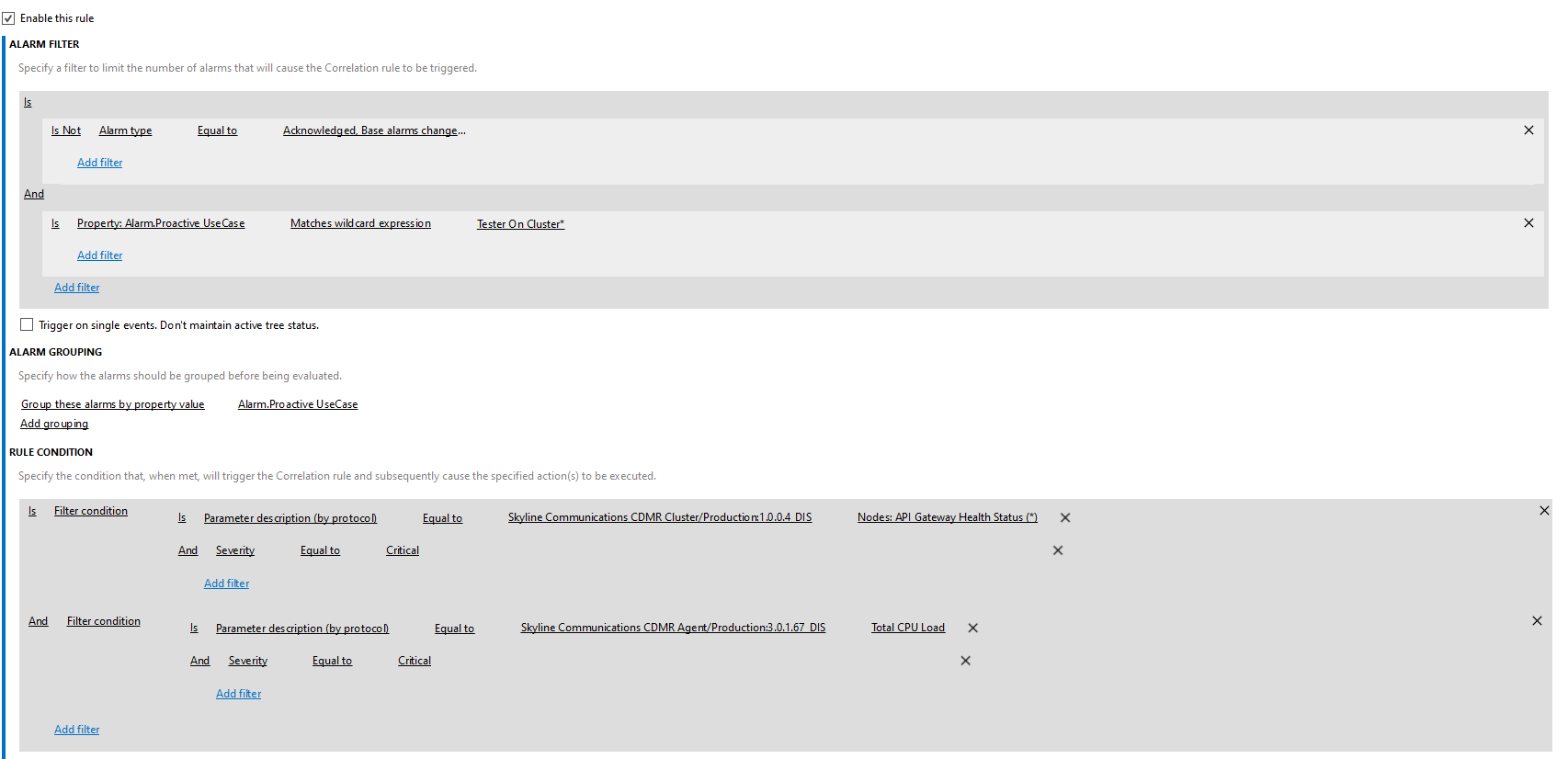

Hi Ken,
Mieke Dryepondt [SLC] [DevOps Advocate]4.29K Posted 24th June 2025 0 Comments
Hi Ken,
I looked into this use case a bit more and applying it on 2 different protocols.
What I wanted was only run the script (correlation action) when 2 alarms on different protocols were active.
To accomplish this I had to:
  1. Filter to focus on a set of alarms iso all alarms. In my use case this is on a custom alarm property "use case"
  2. Group the alarms by this property
  3. Condition on the rule to indicate when the action (run a script) must be executed. in my use case 2 alarms must be active.
Mieke Dryepondt [SLC] [DevOps Advocate] Answered question 24th June 2025
