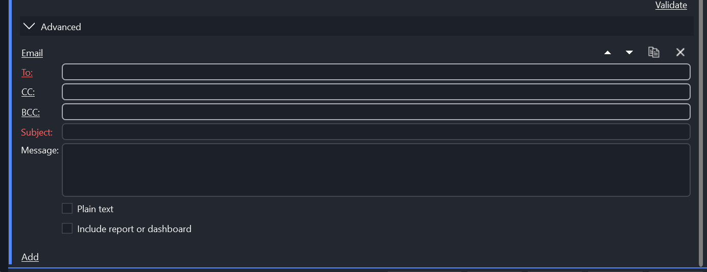

Ben Vandenberghe [SLC] [DevOps Advocate]9.77K Posted 22nd March 2026 1 Comment
Hi David - if I understand your use case correctly, it probably suffices to add at the end of your automation script the necessary logic to dispatch a mail.  That can be done native as an 'email' function in the automation script (as illustrated in the screen cap below), or alternatively it would be written up in C# as part of your automation script.
