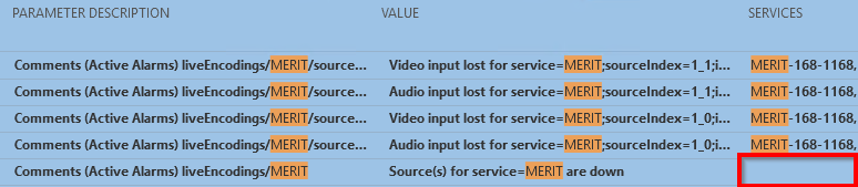

Added screenshot mentioned in comments below showing missing services entry for the Source(s) for service are down alarm. Same table as the other alarms.

I tried using an alarm-template condition to block single-source alerts when a dual-source outage is active. In my setup, that approach didn’t work. While testing my correlation rules, I noticed another problem: I group alerts by Service, but the “Source(s) for server are down” alarms don’t show any Service link, so they don’t get grouped as expected. See attached screenshot.
