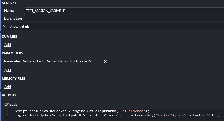

A possible option is to use an automation script to update a session variable:
See below code snippet:
ScriptParam spValueLocked = engine.GetScriptParam("ValueLocked");
engine.AddOrUpdateScriptOutput(UIVariables.VisualOverview.CreateKey("Locked"), spValueLocked.Value);

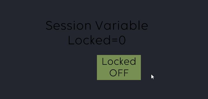

Script Definition:

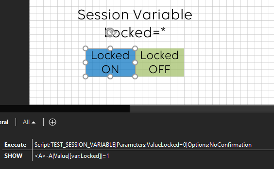

Shape definition:
Execute: Script:TEST_SESSION_VARIABLE|Parameters:ValueLocked=0|Options:NoConfirmation
Show: <A>-A|Value|[var:Locked]|=1
Small Animation:
Hope it helps.
