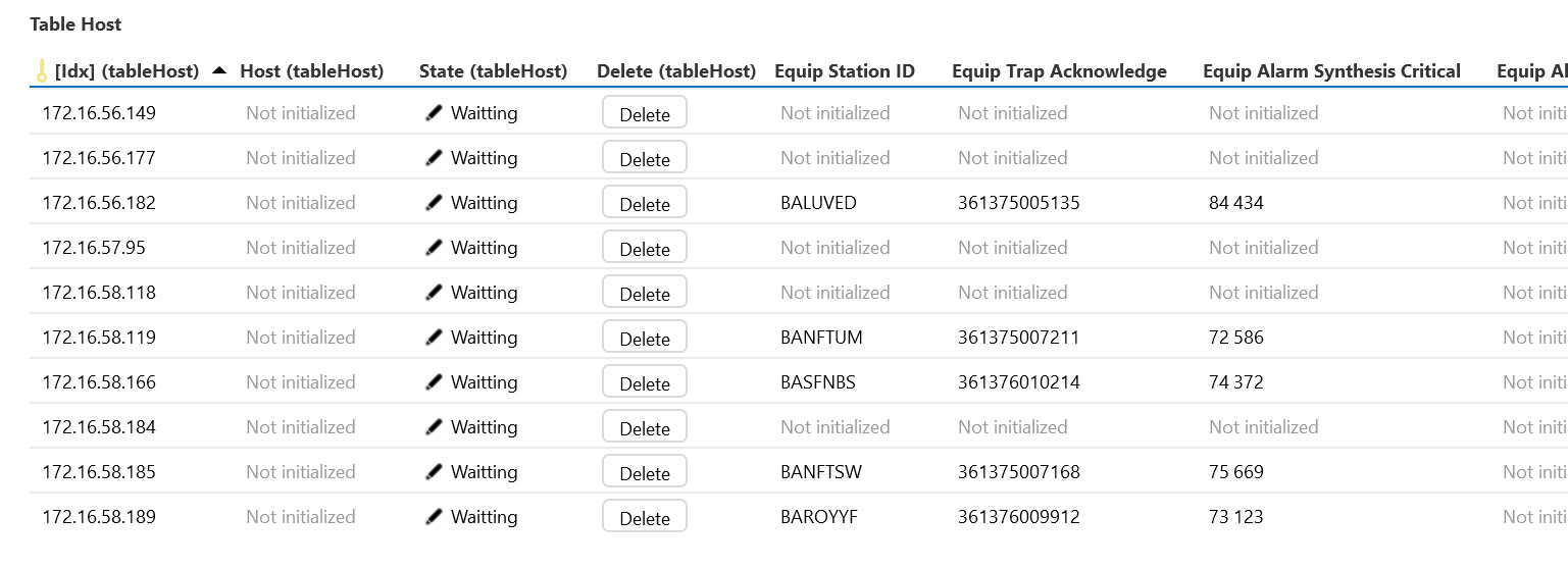

Im added a image ofwhat type of project im doing, at this moment u have a table with IP as IDX and some polling to execute SNMP get for each IP.
Im using the NT_SNMP_GET with the defail connection on the element.
I would like to know if is the correct way from performance or use idip could be better. for the timeout of the host im using the response emply for NT_SNMP_GET.

Making use of ipid would make it more complex.
Best to either use the NT_SNMP_GET like is being done now. Or when all OIDs to be polled are the same and the IP is the only difference, make use of a multi-threaded times, as described here: https://docs.dataminer.services/develop/devguide/Connector/AdvancedMultithreadedTimersSnmp.html
