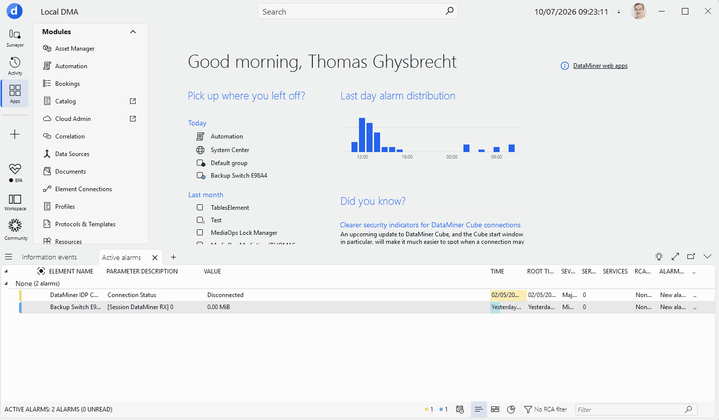

Hi Ramesh, make sure that the 'NoConfirmation' option is set in the Hyperlink.xml for that hyperlink, otherwise the pop-up will be shown as you mentioned.
When I trigger such an interactive script from a hyperlink in the alarm console with that option set, it should open the link immediately. This is how my hyperlink value is structured 'MyAutomationScript||AlarmId=[ALARMID]||Tooltip|NoConfirmation,CloseWhenFinished'.

Thanks for sharing the hyperlink and code. I redid my testing with exactly what you provided, and this seems to be working on my end. Could you confirm the DataMiner version you are using? (My testing was done on the latest version)
The only way I can reproduce the pop-up, is to remove the 'NoConfirmation' option. But that pop-up is then shown before the script actually runs. If I understood your experience correctly, it only shows after the script was executed. Could you scroll down the list of parameters in that pop-up and check what is says at the bottom? I would assume that it says 'Completed: SUCCEEDED' with an 'Execute now' button next to it.
This behavior you are seeing does not seem correct. My current assumption is that this may be behaving faulty on an older version that you may be running. (to be confirmed)
