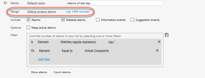

For the daily FDIR, could it work for your use case to use a sliding window to retrieve alarms within a defined time frame, and then apply additional filters (including Regex expressions) to further refine the output? The following example, retrieve the last 24 hours of active alarms and filter them out by element name (different ways to achieve this):
For the weekly delivery, I think a GQI ad-hoc data source is a good option because it will enable the extraction and reporting of the events using complex criteria.  We have in our catalog a sample of this GQI that will probably be a good starter for your solution. Find the item here.
