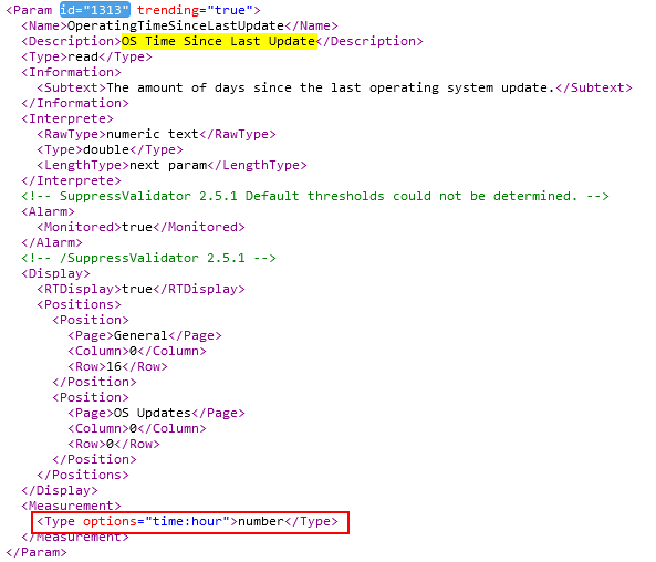

For example, I have the following parameter
This parameter has the following definition:
As you can see in the screenshot, the parameter will measure the number of hours. You can find more information about this option in DataMiner Docs (options for the measurement type number)

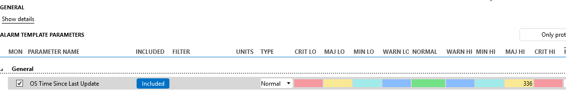

Based on this, for example, I would like to generate a major alarm if this parameter is higher then 14 days. In this case I will need to set the number of hours that represents '14 days' in the alarm template (14 * 24 = 336)
After the alarm template to the element, I should see the parameter monitored:
In this example, the severity is 'Normal' since 14 days didn't pass yet.
