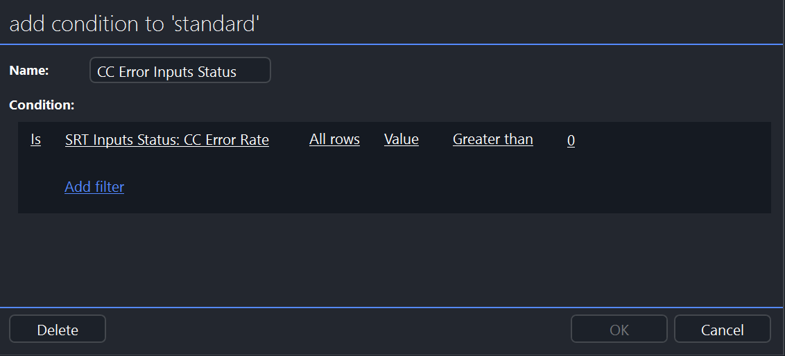

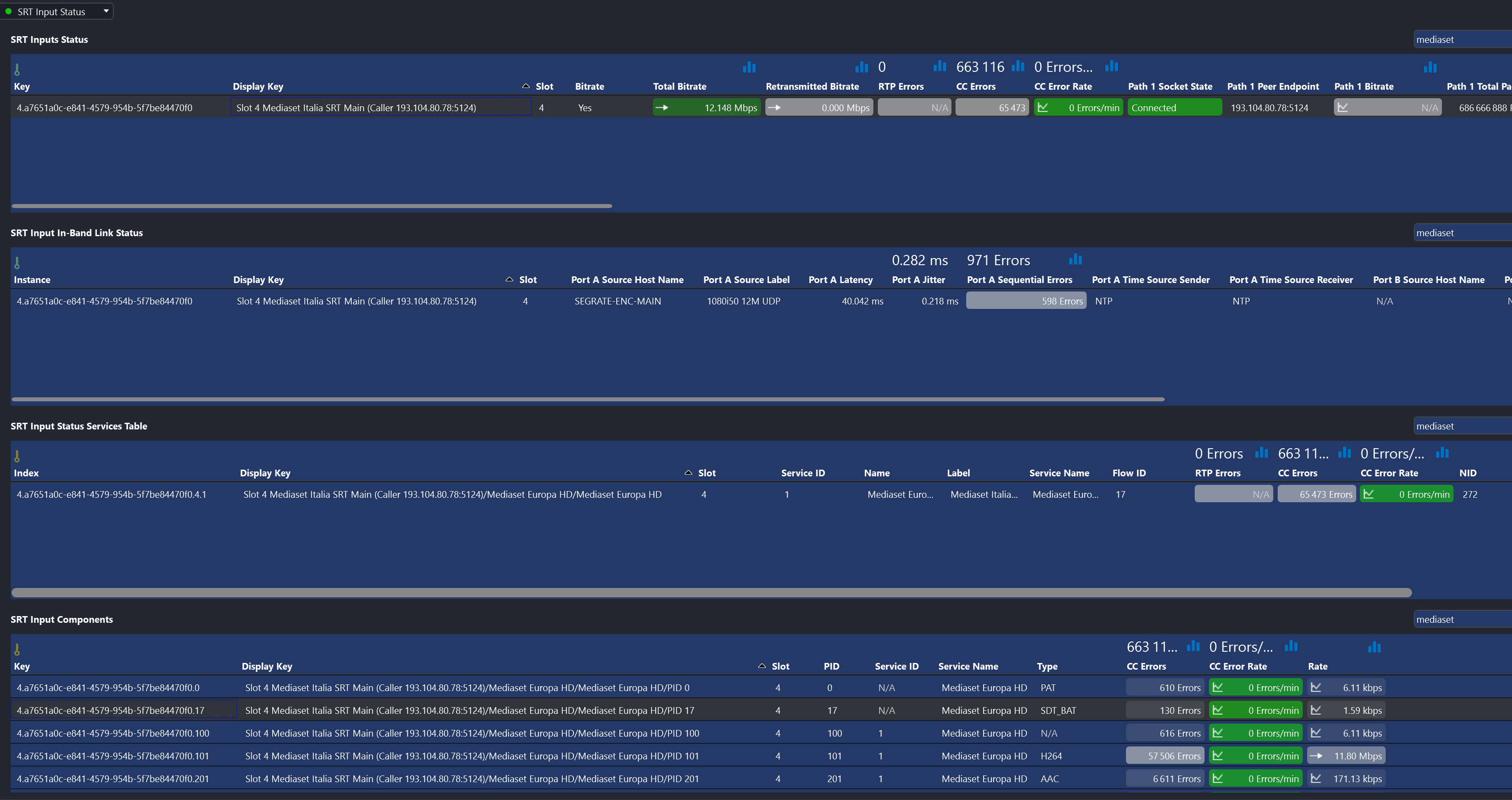

I wanted to create an alarm template with some conditions. But I guess the problem is the different index in the tables, because it's not working.
Table:
The overall SRT Inputs Status CC Error Rate is the base, if there is an error already I don't want to see the other tables here complaining about CC Errors as well.
I used this condition for SRT Input Components and SRT Input Status Services:
Does it not work like I want because the index is different?
4.a7651a0c-e841-4579-954b-5f7be84470f0
4.a7651a0c-e841-4579-954b-5f7be84470f0.4.1
4.a7651a0c-e841-4579-954b-5f7be84470f0.0 etc.

Alberto De Luca [DevOps Enabler] commented 3rd July 2026
Have you tried if you add "*" or "?" in the filter?
E.g. *Mediaset Italia* or Slot 4*
I believe in your case could work also with the display key – but if not, I'd try by filtering on 4.a7651*
Stefan Schedletzky [DevOps Advocate] commented 6th July 2026
Hi Alberto,
this should work for every row in the table. This one is just an example.
Paulo Henriques [SLC] [DevOps Advocate]2.06K Posted 17th July 2026 0 Comments
Hi Stefan,
You are right, it doesn't work because there is no direct relation between the two tables.
There are 3 relevant tables, all linked via foreignKey=14000 (SRT Inputs Table):
  • SRT Inputs Table (14000) — Master config table, one row per SRT input
  • SRT Inputs Status (11200) — TS-level stats, 1:1 with SRT Inputs (one status row per input)
  • SRT Input Components (3000) — PID/service-level detail, 1:N with SRT Inputs (multiple rows per input)
Both 11200 and 3000 use 14000 as the join point, making them siblings rather than parent/child. Alarm template conditions can only reference columns within the same table (same row) or columns from a direct parent table (via foreignKey), so cross-referencing between sibling tables is not supported.
