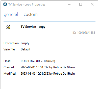

In newer versions of Cube you can right click a service and see its host via the properties window.

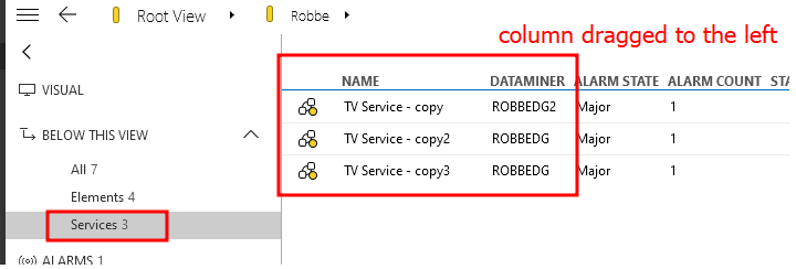

If you need to check many at once, you can go to the surveyor in Cube and click the view where the services are under (or the root view) and filter on service. Then on the right you can find a column "DATAMINER" showing the host. You need to scroll a bit to right to get to it though. You can however drag the column to the left to see it close to your service names.
