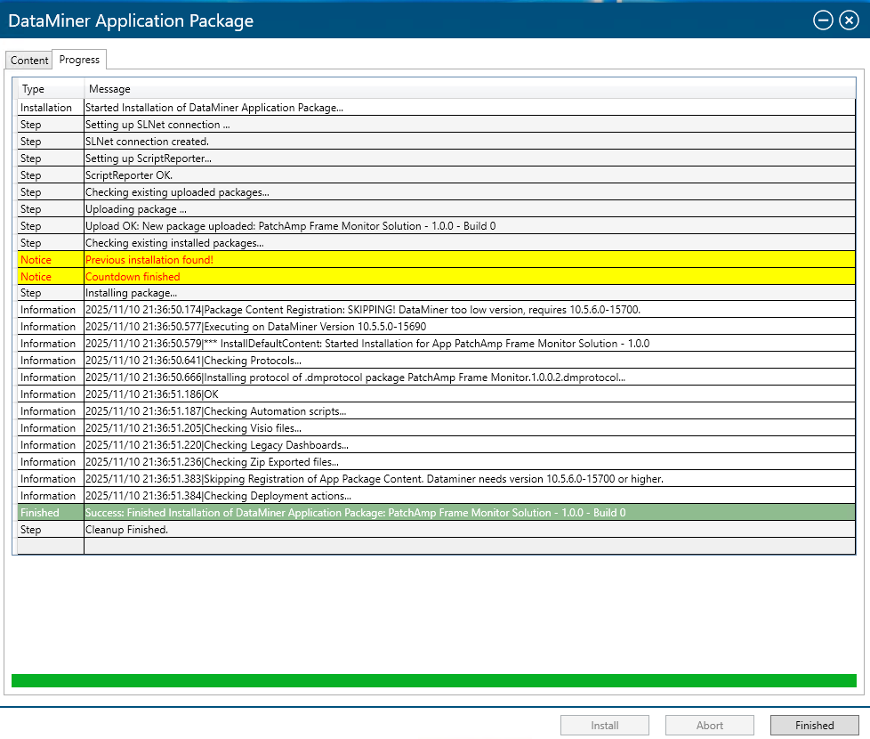

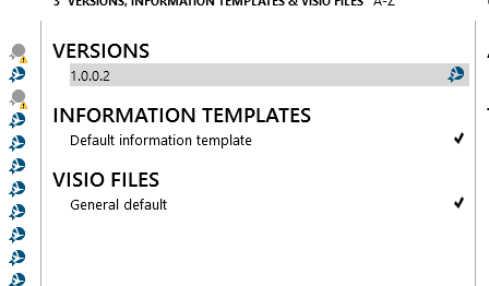

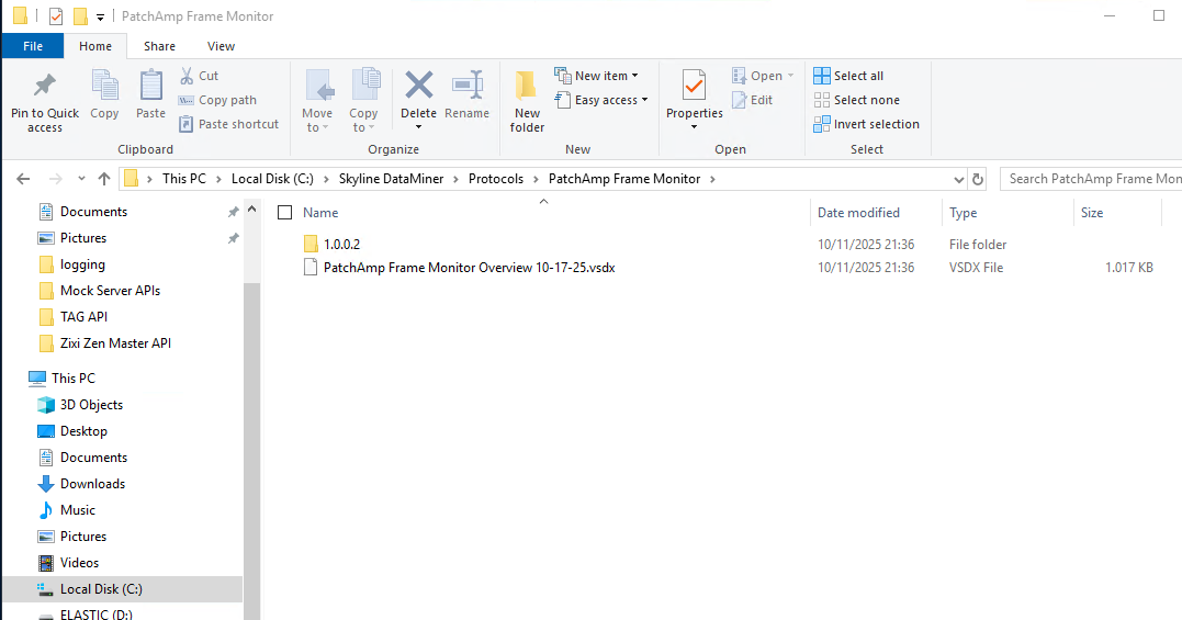

I have a dmapp that contains a visio file and points to a connector in the catalog to install the latest version. When running the dmapp, it installs the connector and visio successfully (since it is shown in the directory), and the connector shows on cube. However, the visio file does not show on cube as the default view for the connector. It only shows the 'General' default visio. Is this an issue that has been seen before? I've tried some other ways to get it to work, but I have not found a solution.

The issue was that the visio name did not match the protocol name. The visio name MUST match the protocol name for it to be visible on the Cube. Thank you.
