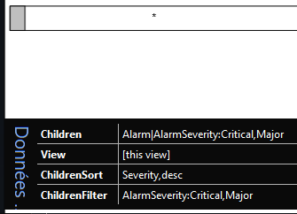

actually i have i shape with this parameters

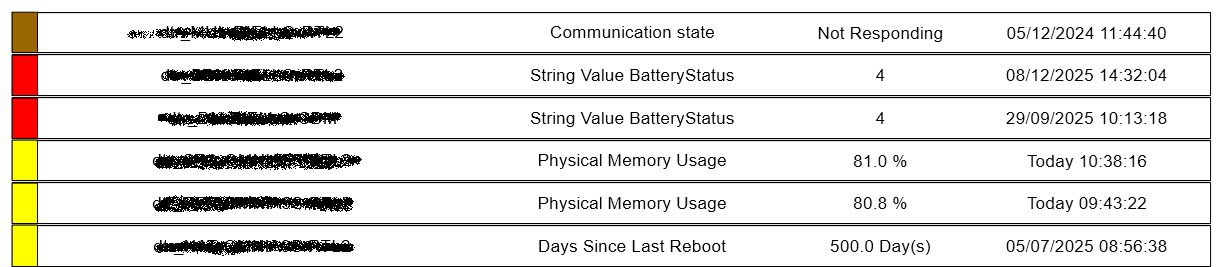

it create a good table with all the alarms into this view (like below)
But in my case i want only to show the critical and Major Alarms. The ChildrenFilter didn't work, because i always have the Major and Minor alarms too

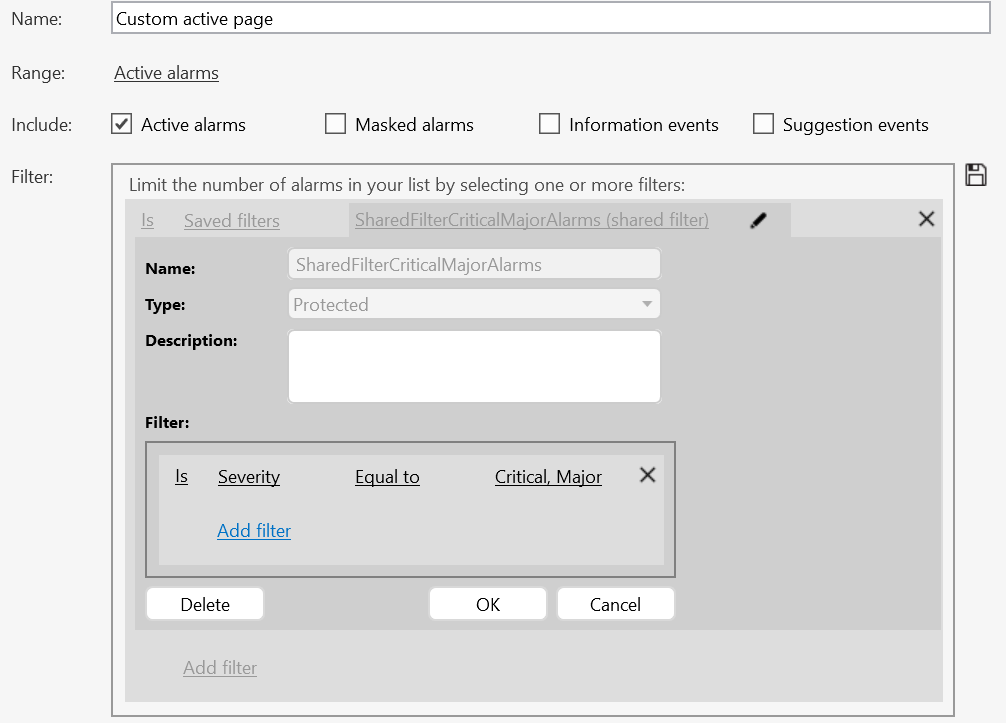

As the Generating shapes that represent alarms | DataMiner Docs explains, there is no such concept as AlarmSeverity when using the ChildrenFilter. Instead you need to make an alarm filter in the alarm console and reference that one in the Visio.
Group shape:
Children : Alarm
ChildrenFilter : SharedFilterCriticalMajorAlarms
