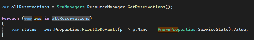

José Silva [SLC] [DevOps Enabler]1.91K Posted 3rd December 2025 0 Comments
Hi Jason,
If I’m not mistaken, the property you’re looking for in the reservation is “Service State.”
You can access it like this:
