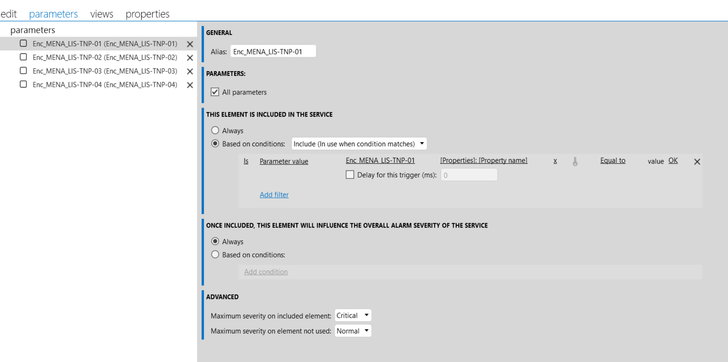

Hello everybody!
I'm posting this question as I'm struggling with a new service I just created.
In my service I added 4 encoders, each of them with a condition: they can be inclueded in the service if the custom property "x" has the "OK" value
By default this property is empty and all of them are excluded.
Then I type in the "OK" value on one of them and I'd expect this element to get inclued....but it doesn't happen!
Do you have any suggestion?
I'm running DataMiner v.10.3.0.0-13537-CU9.
Thank you for helping!

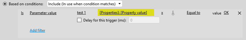

Sebastian Ulloa [SLC] [DevOps Advocate]2.34K Posted 16th July 2025 1 Comment
Hi Ricardo,
The condition is almost correct. You have to change it so instead of comparing the Property Name, the service evaluates the Property Value:
Hope that helps!
