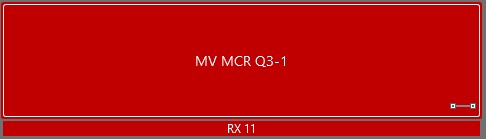

In previous versions we had tab highlighting when we've selected an output which had an connected source to it. It would be able to highlight the correct tab so operation knew where the source is coming from even when an other tab was selected
Selected destination:
Highlighted tabs in sources
However when i connect with the newer cube version i end up with this:
How can i get the behavior of tab highlighting back?
