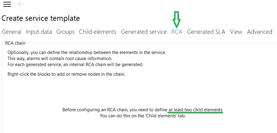

Depending on what you already have for the Nimbra, you may want to define the service and then template the RCA, so that it can be reused for all the services that share the same architecture – adding a screenshot

Depending on the Nimbra definitions you have, a redundancy group on the decoder might be of help / and or dynamic inclusion in the service: in any case, once you've found a suitable service model, the RCA can be templated in the "Service Template" - that way you can re-use it for multiple services
