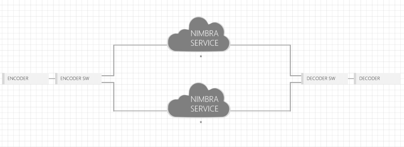

Hi all,
I’d like to create a RCA setup for the service chain as attached.
1. The devices in rectangular shapes are static. There are no DCF capabilities for some of the drivers.
2. The Nimbra services have a dynamic path depending on availability. There is already DCF connections created for the Nimbra services.
Given this situation, kindly advice what would be the best method of creating RCA for the end to end service seen below.
The question arises due to the fact that the service has both elements and services. In addition, it also contains static and dynamic components.
Thank you in advance!

Alberto De Luca [DevOps Enabler] commented 13th December 2025
Am I correct the visio gives a representation for an SPTS?
Or is it a different type of distribution?
Depending on what you already have for the Nimbra, you may want to define the service and then template the RCA, so that it can be reused for all the services that share the same architecture – adding a screenshot

Hi Rajesh, typically this scenario is best studied with your squad / account manager as they can better advise on the data structure that will better fit your protocols & elements.
Depending on the Nimbra definitions you have, a redundancy group on the decoder might be of help / and or dynamic inclusion in the service: in any case, once you’ve found a suitable service model, the RCA can be templated in the “Service Template” – that way you can re-use it for multiple services
HTH

Alberto De Luca [DevOps Enabler] commented 14th December 2025
P.S. Have you already trued embedding the "Nimbra" service into a higher level service as a child? This video had a lot of info o service definitions:
https://www.youtube.com/watch?v=pK5z0nzfW_Q
