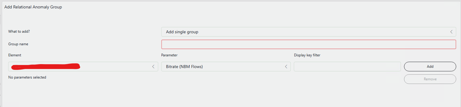

Hi Dojo,
I've started to experiment with RAD Manager and I've hit a bit of a snag.  When adding Parameters to a Group with RAD Manager there is an option to add a Display Key Filter. The issue is, the table that my parameter exists in doesn't have a Display key, only Primary and Foreign.
Can anyone suggest a work around to get my required Parameters into RAD?

Hi Dave,
In that case, you can define the filter on your primary keys directly in the Display Key Filter section of the RAD Manager app. If you still run into any issues, feel free to share the details and we’ll be happy to help.
Dave Keller [DevOps Enabler] commented 8th December 2025
Hi Veerle,
I thought I had already tried the Primary key, but you are correct, inputting the Primary key works – thanks.
