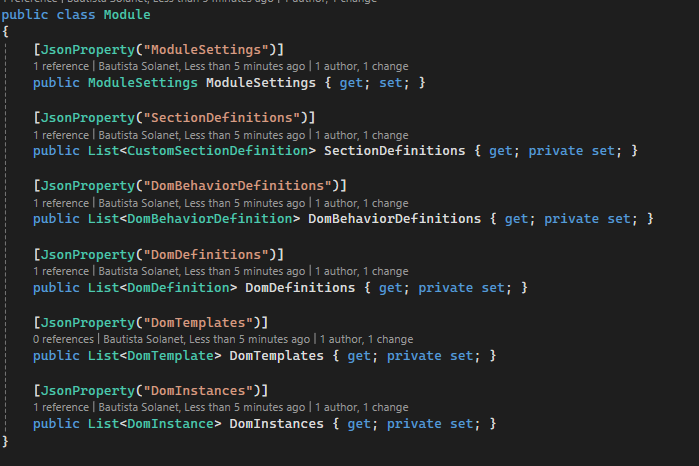

Bautista Solanet [SLC] [DevOps Advocate]1.35K Posted 21st July 2025 0 Comments
For the time being, I'm using this class for deserializing Modules:
Somethings to know is that if you use this class, you're going to need to set your JsonSerializerSettings to have TypeNameHandling.Auto and a ContractResolver with IgnoreSerializableInterface set to true. You also can't use this with SecureNewtonsoftDeserialization as that will throw an error, so stick to JsonConvert.
