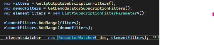

Code seems fine as Tom mentioned but I would recommend putting together all watchers of the same type, for example in your case, you would only need one "ParameterWatcher" instead of 2, you can add as many elements as you need having a list of SubscriptionFilterParameter where you can add both of your filters and consolidate them in a single ParameterWatcher.
something like this
