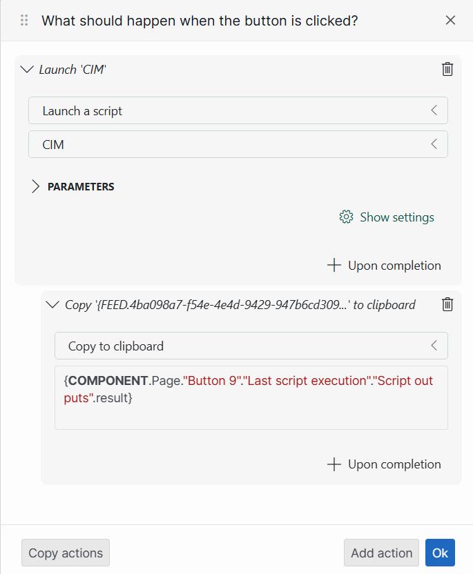

In my low-code app, I have a button that runs an automation script. I also have a text module in my designer that retrieves the script’s result after clicking the button and displays its contents (using its variable-formatted text content). This part works fine.
However, when I try to copy the script’s result to the clipboard as another step in the button click actions immediately after launching the script, nothing gets pushed to the clipboard. If I click the button a second time, the previously generated result is then copied to the clipboard.

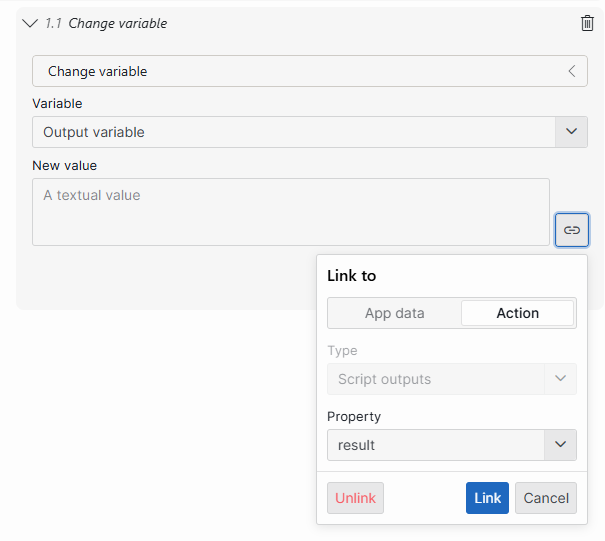

To use the button's value before it's actually exposed, you can first store it in a variable, and then copy that variable's content to the clipboard. Starting from version 10.5.9, this can be done using the Action tab when linking the output to a variable:
Your event configuration should look something like this:
