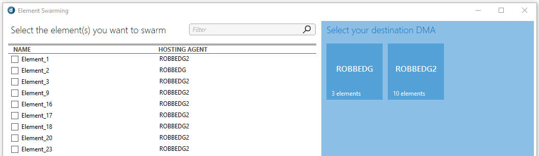

Additional question related to the UI. Currently if a DMA is down, the elements hosted on that DMA are typically missing in the surveyor or in an error state referring to the unavailability of the hosting DMA. I assume that this is not applicable then for the UI where you can swarm an element (Cube). So all elements in that UI will be available for swarming despite the status of the DMA. Correct?

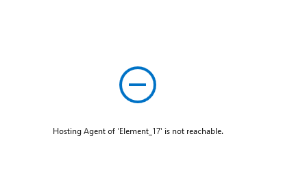

Elements which are hosted on a DMA that is down, should still be visible in the surveyor as such:
They are visible but not possible to interact with. Opening the card shows that the host is unreachable.
Via the available UI in Cube right now, these are included and can be swarmed.
