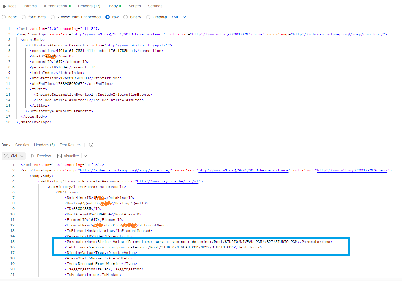

But when i tried the method : GetHistoryAlarmsForParameter
with this Request :
<soap:Body>
<GetHistoryAlarmsForParameter xmlns="http://www.skyline.be/api/v1">
<connection>4b78620e-97a5-4d4f-ab80-edf3134bbffb</connection>
<dmaID>myID</dmaID>
<elementID>1947</elementID>
<parameterID>1004</parameterID>
<tableIndex>PGM/FQ04</tableIndex>
<utcStartTime>1768826220000</utcStartTime>
<utcEndTime>1768826760000</utcEndTime>
<filter>
<IncludeInformationEvents>1</IncludeInformationEvents>
<IncludeEntireAlarmTree>1</IncludeEntireAlarmTree>
</filter>
</GetHistoryAlarmsForParameter>
</soap:Body>
The Result is empty 🙁 :
<soap:Body>
<GetHistoryAlarmsForParameterResponse xmlns="http://www.skyline.be/api/v1">
<GetHistoryAlarmsForParameterResult />
</GetHistoryAlarmsForParameterResponse>
</soap:Body>
Is there someone who can explain to why only this method didn't work for me, or maybe i just used it badly
Thanks in advance for your help
ps : this i a restricted view of the element table with this ID i tried to filter
Olivier SAGET Selected answer as best 20th January 2026
Olivier SAGET111 Posted 20th January 2026 1 Comment
Hi again Catarina, more strange. Like the docs said it can be left empty and when i tried without tableindex data i've got some result.
After that, the tableIndex i've got into the result isn't reusable into a new query !!
Catarina Grilo [SLC] [DevOps Advocate] Posted new comment 20th January 2026
Catarina Grilo [SLC] [DevOps Advocate] commented 20th January 2026
From your initial screenshot, it appears that this parameter belongs to a table parameter. When that’s the case, you need to fill in the tableIndex field.
Normally, tables have an extra column that serves as the index (primary key). The value of the index in the corresponding row is what needs to be entered in the tableIndex field.
