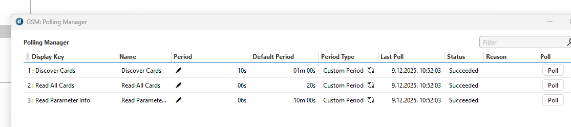

we are doing test for the integration of the Miranda iControl GSM driver into Dataminer. We got everything working but we noticed that time to raise alarm is not that fast as we would like.
Currently we are using Miranda iControl General version 3.0.3.8 and iControl version 8.10.
We have tried to change default period values in Pooling Manager menu for Discover Cards, Read All Cards and Read Parameters but time for alarm remains more or the less the same. Sometimes little bit faster, sometimes slower, there is no pattern visible.
