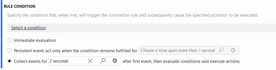

Besides what Miguel has mentioned, and depending on your use case, you could look into the "Collect events for ... after first event, then evaluate conditions and execute actions" trigger mechanism.
This could serve almost as a throttling mechanism.
