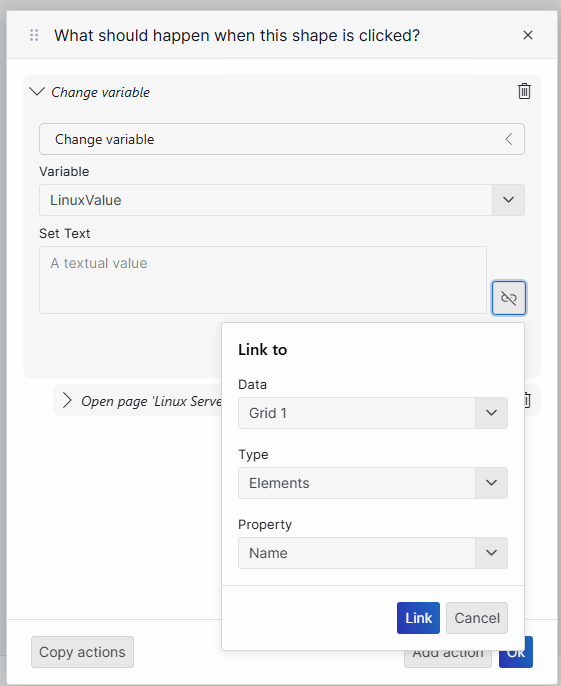

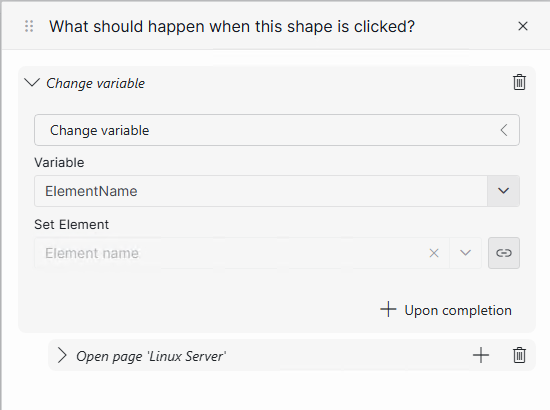

I tried doing this using variables, by adding a click action on the Grid to update a variable before opening the next page. I tested both an Element-type variable and a Text-type variable, but in both cases the page opens and the variable does not seem to update based on the clicked item. As a result, the second page opens without the context needed to apply the filters.

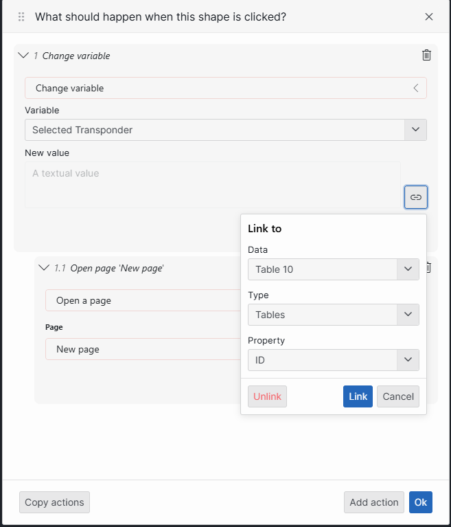

This approach should work - I've just tested it on my own application and it runs without any issues, so the problem might be related to configuration.
The first step is to configure the action (for example, on click action on the grid or table column):

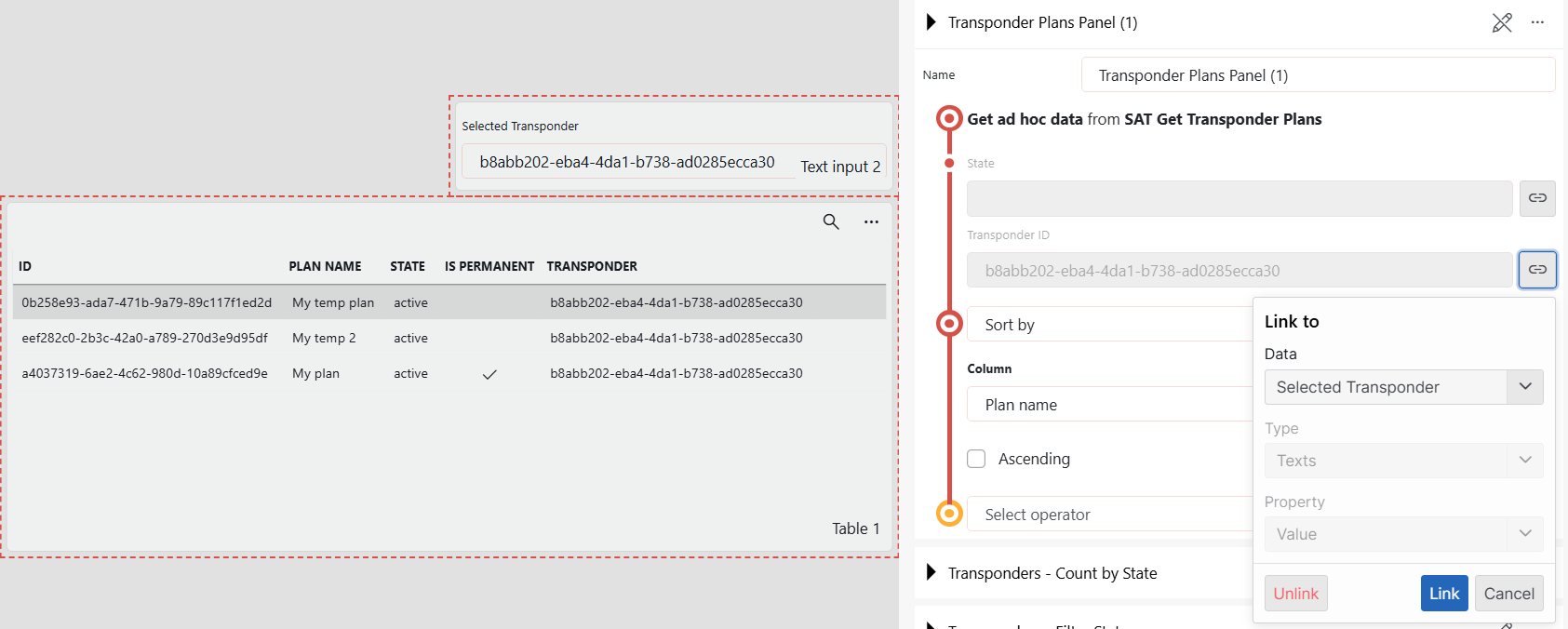

Additionally, on the page that opens (the detailed view), you need to include this variable, either by passing it as an input argument or by filtering based on it, depending on how you are using it and the type of query involved. For example, if you are using an ad hoc data source, you should pass this variable as an input argument:
