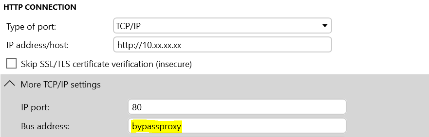

Based on the symptoms you're describing, it seems likely that there is a difference in the proxy configuration between the production and staging server.
To troubleshoot this step by step, the first thing to verify is whether the DataMiner production server is expected to route its HTTP traffic through a proxy.
If you're certain that it shouldn't, you can try adding the bypassproxy keyword to the bus address of the HTTP connection. This will instruct the system to bypass any proxy settings configured at the WinHTTP level.

Muhammad Yousif Maher commented 22nd May 2025
Still timing out even adding the bypassproxy
