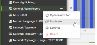

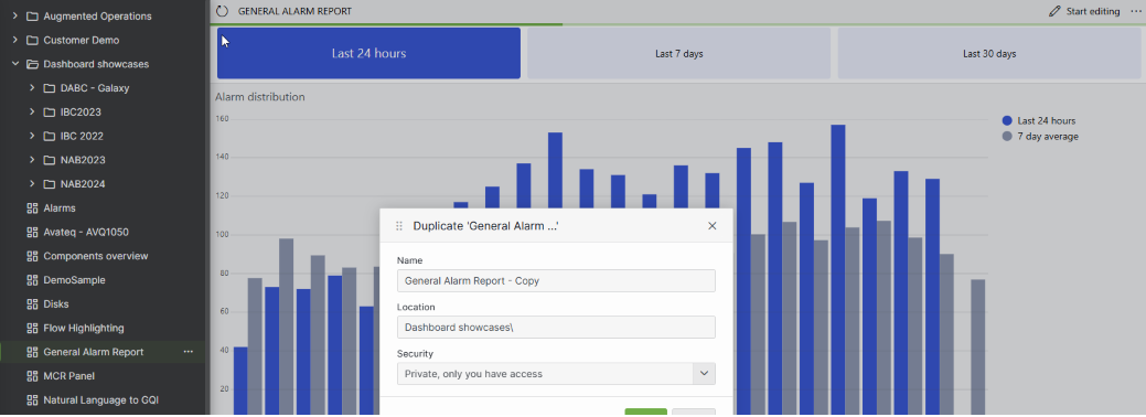

I'm wondering whether you can create a copy of the dashboard for yourself and then edit it afterwards. I'm not sure if it works that way, but it might be worth giving it a try.
Thomas Vogel Posted new comment 29th July 2026
Thomas Vogel commented 29th July 2026
I think, I also don't have enough rights for that. I can only select "Open in new window" from this popup.
