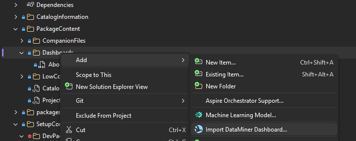

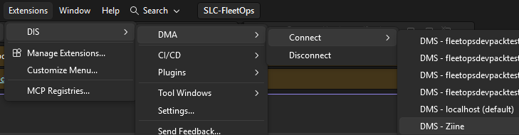

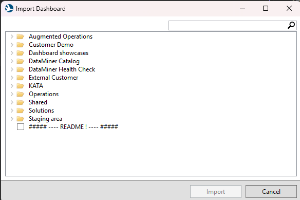

You can deploy this dashboard on your own DMA with a little trick. In Visual Studio, make sure you have DIS installed and create a new DataMiner Package Project.
Then, in the top bar, go to Extensions > DIS > Connect to ZIINE. (You might need to add it in the Settings first...)
Next, inside the package project itself, locate the PackageContent/Dashboards folder. Right-click it, and you should see the option to import the dashboard from ZIINE.
Now that you've created a new package containing this dashboard, open the package's .xml file and publish it to your own DMA. The dashboard will then be deployed on your own DMA and you can edit what you want :)!
