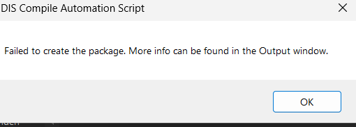

Hello,
I created an automation script with Visual Studio. During the publishing I get this error.
Thanks for help!

Hi Ömer,
A new version of DIS (3.1.13) has been released which should fix this issue. Can you update to this version and verify whether the issue no longer occurs?

Ömer Eryaman [DevOps Member] commented 23rd October 2025
I updated DIS, and it works now. It was just confusing because in some other projects, the same old version worked fine.

While this System.MissingMethodException is gone in 3.1.13, seems that publishing any project that references another project (ie. .csproj has <ProjectReference Include="..Project1Project1.csproj" />) is now broken.
Error dialog is the same and DIS output just shows:
Build failed of 'C:UserslibeerksourcereposProject5Project5Project5.csproj'

Hi Erko, other developers also noticed this. We released a new version 3.1.14 which should solve this now. Can you test if that version solves it for you as well?
Erko Libe [DevOps Enabler] commented 23rd October 2025
Thanks, 3.1.14 solved it indeed.
