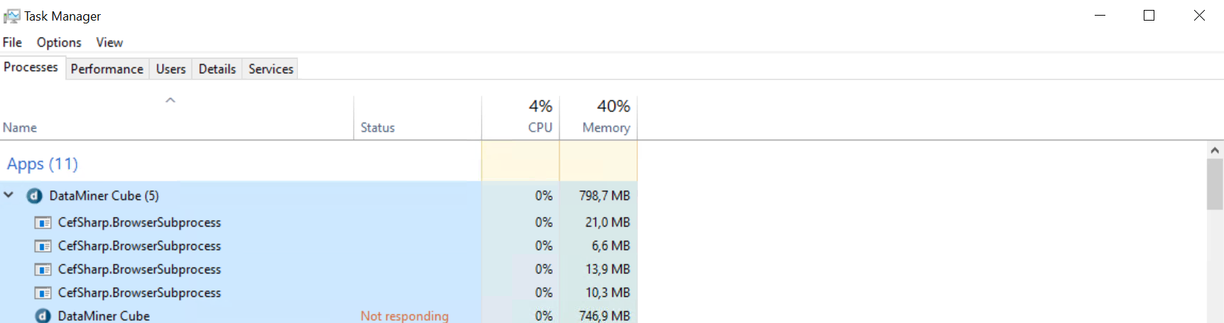

I have a protocol used by only one element. Every time I update protocol, cube(10.5.7.0-15952) freezes while element is restarted, so the cube has to be terminated in Task Manager. Here is the screenshot from Task Manager
and error logs from the cube log file

Can you confirm whether its cube issue, or could it be protocol that should be reviewed?
