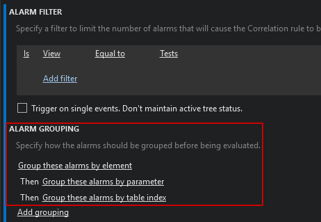

Here's the screenshot of my Correlation Rule.

Hi Trong,
This is happening because the correlation rule no longer maintains the active tree status. As a result, the correlated alarm is updated with every new status change.
To avoid this, you can restrict the alarms that pass through the filters. For example, you could filter only for new alarms in one rule, and then use another correlation rule to filter for normal alarms that have dropped from critical.
Alternatively, you can uncheck the Trigger on single events. Don’t maintain active tree status and group the alarms first by element, then by parameter. If they are tables  you can also group them by index.
This approach maintains active tree status so that not every alarm update triggers the correlation. It also prevents alarms from different elements and parameters from being grouped together.
Trong Huynh [DevOps Advocate] Selected answer as best 24th June 2025

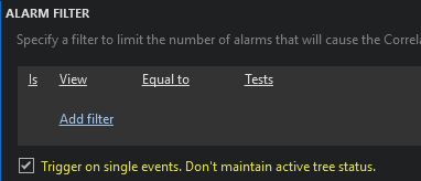

Catarina Grilo [SLC] [DevOps Advocate]3.70K Posted 23rd June 2025 0 Comments
Hi Trong,
To trigger the correlation rule for every single alarm, you need to enable the Trigger on single events. Don’t maintain active tree status.

Trong Huynh [DevOps Advocate]891 Posted 24th June 2025 0 Comments
Thanks Catarina, enable the Trigger on single events. Don’t maintain active tree status seems to do the job.
However I noticed a little quirk, the Correlation rule is triggered everytime the alarm has a property change. Is there an option to disable that? Ideally the correlation rule should only execute the script when the alarm is Open and when the alarm is Cleared.
