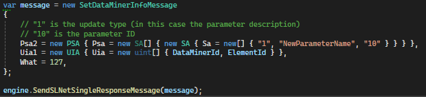

I need to change by an automation, the name of a parameter on a specific element.which function could we use?
Only one element should be affected by this change.

Hi Henri,
The following SLNet call can be used to execute the logic from the "Parameter Names" option mentioned in the other answer. Refer to the Docs for more info about the logic used (it's explained from a connector logic but this is the same background call).
For scripts you'll have to use an SLNet message. Please note that SLNet messages are subject to change, and therefore their use is not recommended, as breaking changes might be introduced in future versions of DataMiner.
Also, this is rather versatile and raw SLNet method, so please don't mind the undescriptive properties of the object used.

Hi. Thanks a lot.
How can we remove with function, a value setted before?
If I use : "" as parameter name, the entry always exist in Description.xml file:

Robin Spruytte [SLC] [DevOps Advocate] commented 24th October 2025
You can indeed revert to the old value using "" as parametername. I'm not sure if this correctly removes the entry from Description.xml, but I do not believe this would be an issue anyway?
