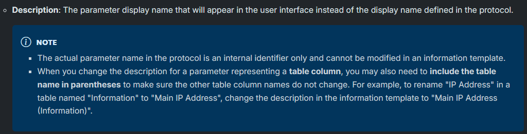

Hi Henri,
I would say that to override a parameter name, the best would be to use an information template as described in Creating an information template | DataMiner Docs:
