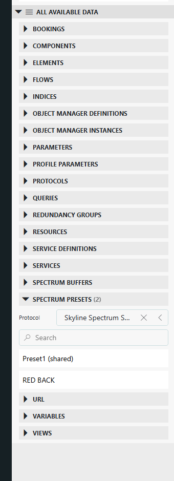

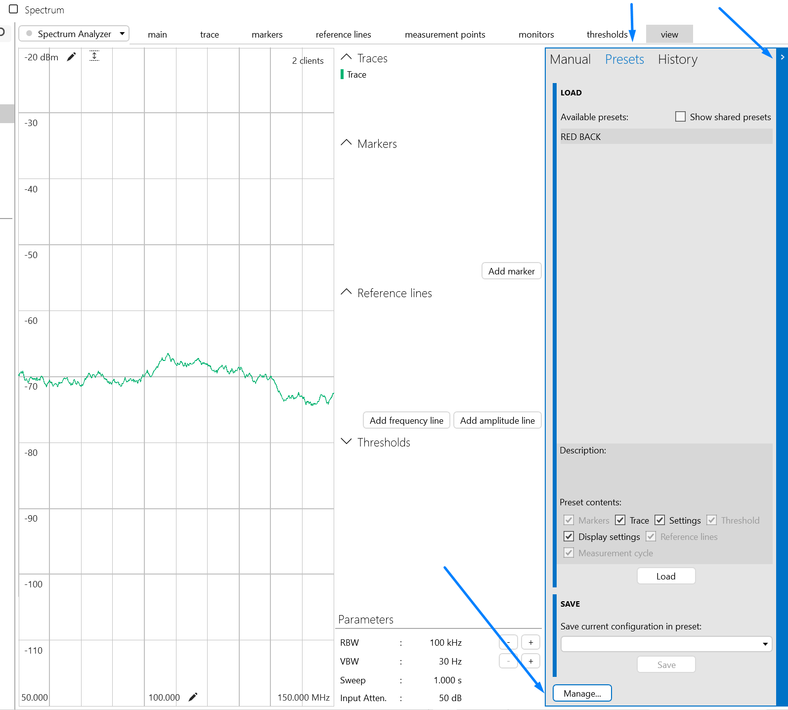

Hi Carolina, to change this in the LCA, you will need to create a preset for the desired colors and settings. This can be done from Cube where Ben pointed out.
You will then need to click the “Presets” tab on the right where you can manage, edit and save your presets.
After configuring your new preset, you will then need to head to your LCA. You will be able to find your presets in the “Spectrum Presets” tab by filtering the protocol where you saved your desired configuration (you may need to refresh your page). Then you can drag and drop your present onto your Spectrum Analyzer, applying your configurations.
