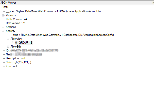

Using a C# automation we want to send an overage email to users with allowview privilege for a LCA
We've  seen that it's possible to see who can view a dashboard in the appinfo.json located on LCA directory, but we are not able to retreive the user accounts info.
The question is: how to code-retreive  the email info for each user in the group ?
or perhaps a direct function is existing 🙂
