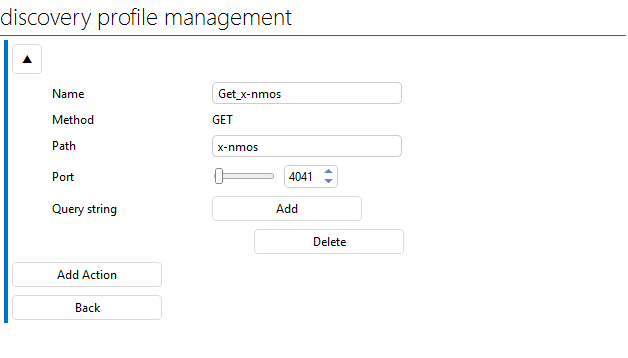

Jan-Klaas Kesteloot [SLC] [DevOps Advocate]1.53K Posted 29th October 2025 5 Comments
Is your Path in the HTTP discovery profile x-nmos or /x-nmos?
I'm assuming that the Path in your discovery action of the discovery profile should be x-nmos (see below screenshot)
Your discovery identifiers in the CI Type seems correct.

It was /x-nmos, I've changed it to x-nmos. It still doesn't find it!
How can I tell which DMA is responsible for doing the searching? This DMS has 8 hosts, 4 on one site, 4 on the other. If the other site is doing the search, it won't be able to connect.
The Dataminer IDP element is running on a host at the same site as the device I'm trying to connect to
