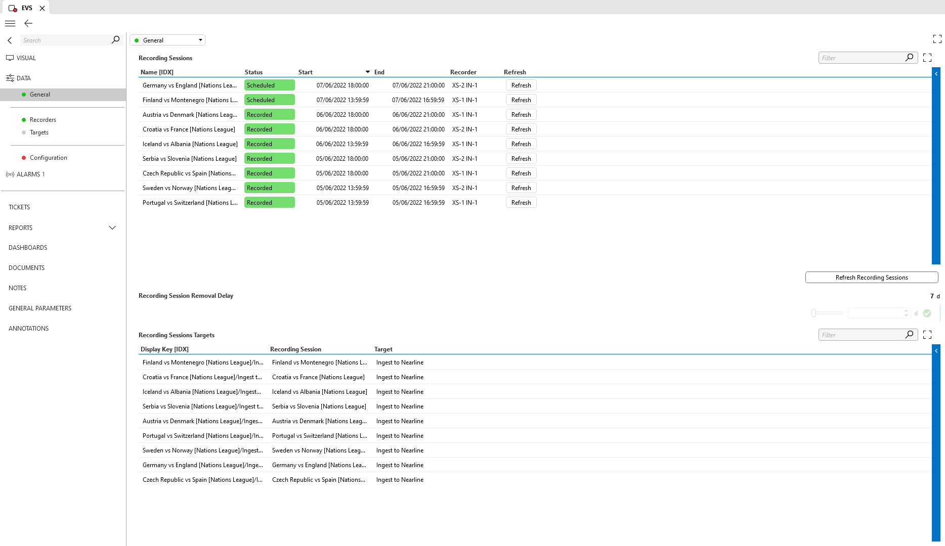

The "General" page provides an overview of the recording sessions and their targets. A recording session is the representation of an ingest block, which exports the data through a recorder. The targets define where the data needs to be exported. Finished recording sessions are automatically removed from the element after a configurable time. You can not only monitor recording sessions with the connector, but also create them! This is not possible through the element card itself, but it can be done using a specific messaging API that has been implemented in the connector itself. This allows for easy creation of, for example, automation scripts to create or update recording sessions.

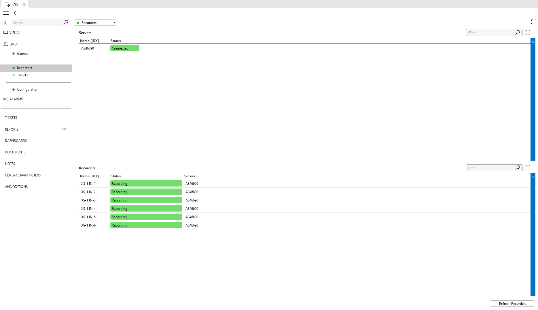

The "Recorders" page shows the recorders and the server(s) that they are linked to. A recorder is a business component in charge of processing the recording session.

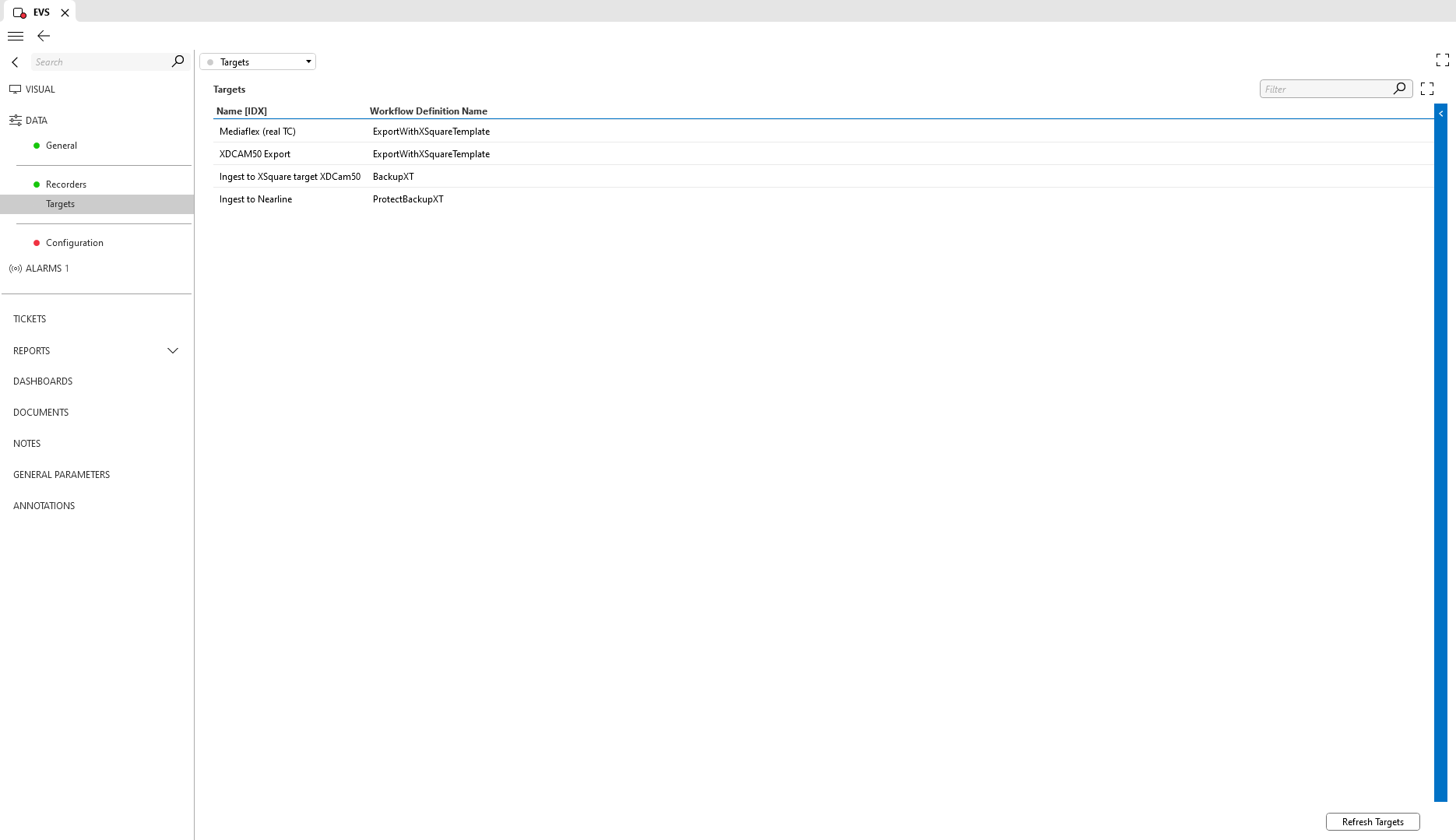

The "Targets" page shows an overview of the configured target definitions. Recording sessions have one or more ingest targets, which are used to trigger an ingest workflow.

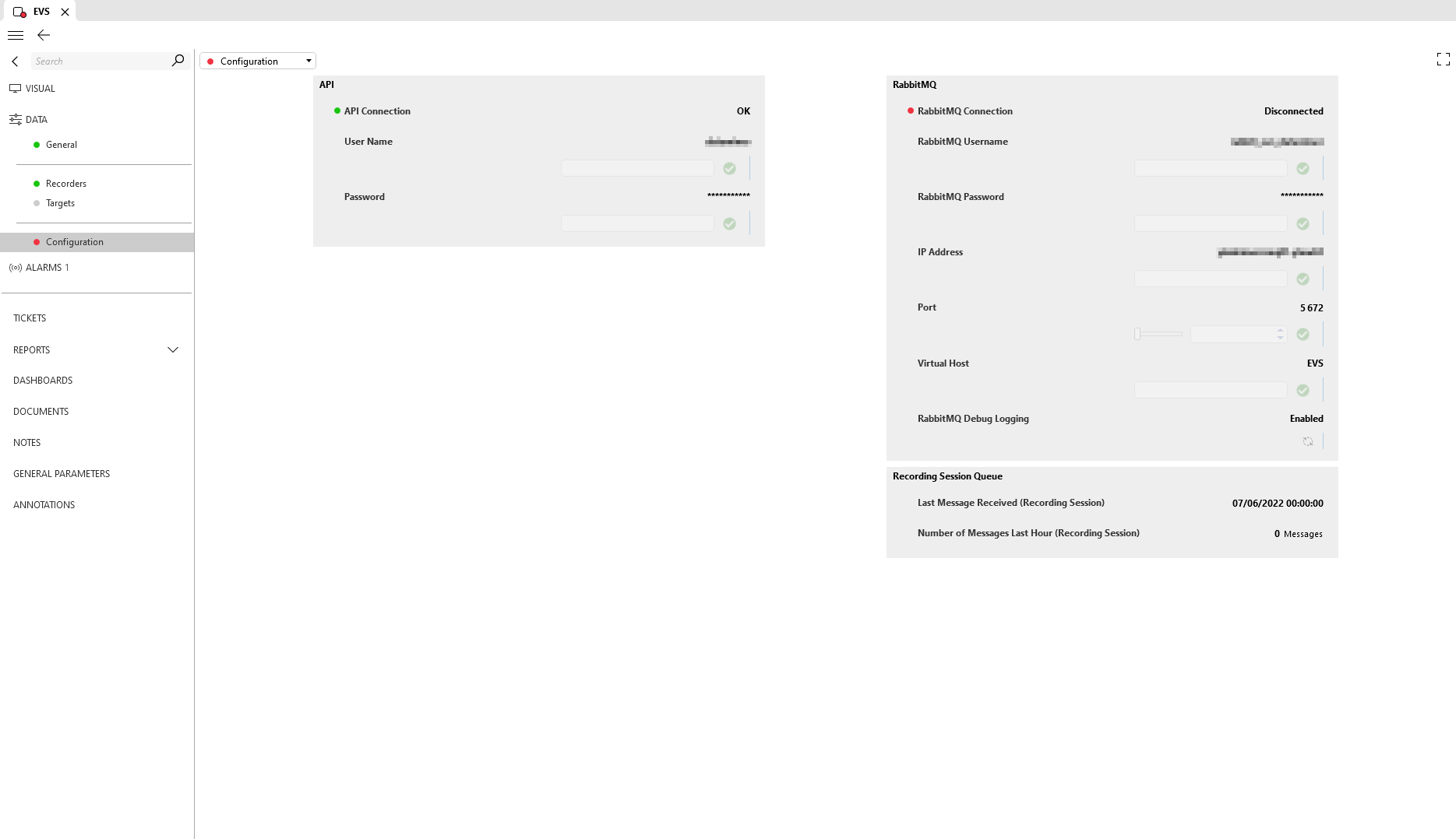

The "Configuration" page contains the parameters that need to be configured both for the authorization of the REST API and the connection with RabbitMQ.
