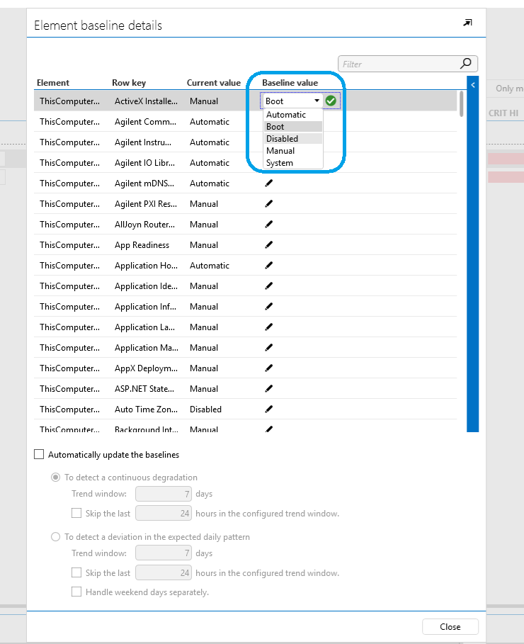

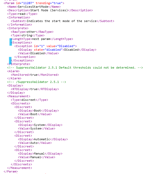

I would suggest to either create an addiitonal Discrete value OR an Exception value on the parameter such as "N/A" or "Disabled". Then you can put the baseline on that value.
Example in protocol for Exception value:
Then you can put it on that new value:
What do you think of the suggestion? Could this work out for you?

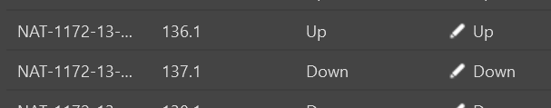

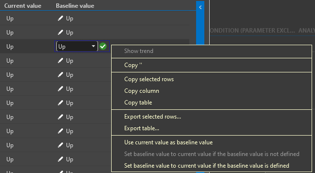

This wouldn't work for us, I'll add more screenshots above to describe how we use it. But basically we set up alarms for both "Up" & "Down" states, then set the baseline value on each channel to either "Up" or "Down," or we omit a baseline to not alarm on that specific channel.
But I think if we can't remove a baseline then we'll just have to make many rows of filters, or duplicate the element and start from scratch.
